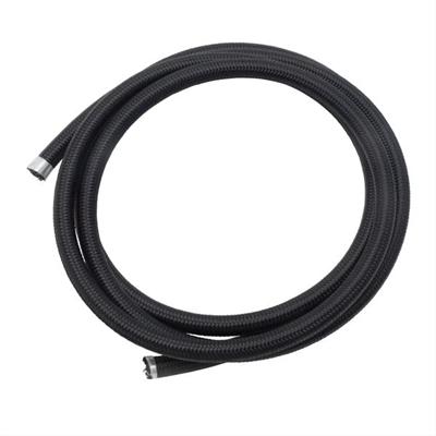

A lot of the stuff designed for AN type fittings would work well. I recently made a set of trans oil cooler hoses using Russell brand hose, it was soft and pliable, with a black nylon braided outer wrap.
Edit
It was 1/2 or 5/8, can't remember. But larger sizes were available too.

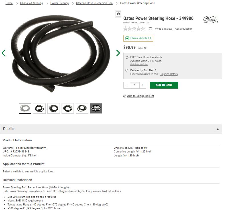

Here's what I used. I was very pleased with it. Very flexible too.
I ordered 20’ of it. The stuff Eric mentioned looked really nice too. I called their customer service with some questions about the product. The guy on the other end of the phone seemed like he wanted to take a nap and was not very helpful.

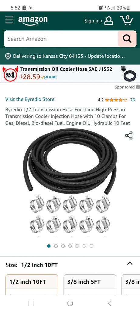

Was looking for the stuff I used,but ran across this. I don't know why it wouldn't work,and way cheaper than what I used.
