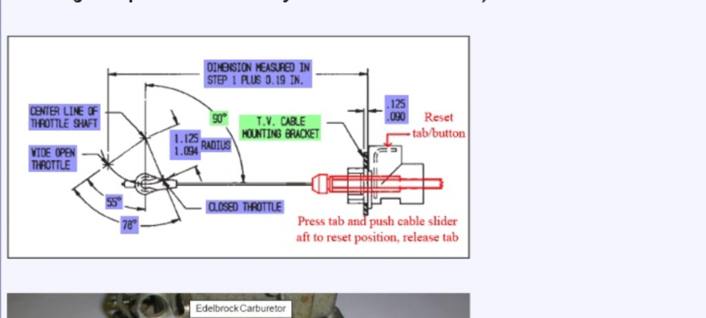

But can one be converted to electronic shift though? I know that a factory 700r4 has a long TV cable going all the way to the carb, but I was wondering if anyone tried to eliminate the TV cable entirely and retrofit some sort of electronic shifter to one.
5,446
8,684
This is what your geometry at the throttle plates needs. As for an electronic shifter on a 700r4 there are no electric shift solenoids,so no way shift it electrically .
