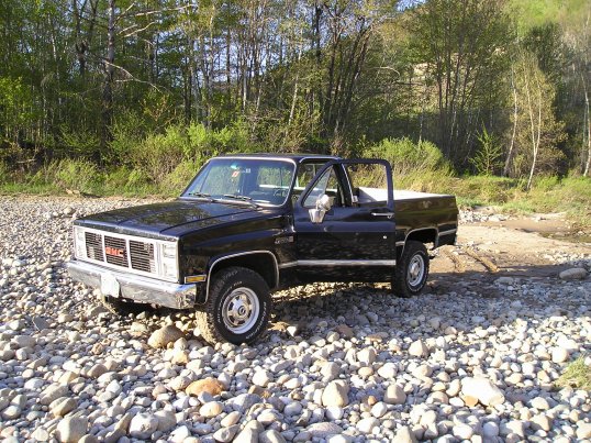

They will provide more support but you shouldn't expect any appreciable rise in curb height.
I think a stock spring stack for a 3/4 K series has only one more leaf than the stock 1/2 ton (3 vs. 2).
If the current spring sets are sagging - and you install new 3/4 sets - it will appear to you that you got a bit of a lift. But in reality you will just be back to the design stock height.
If you are not aiming for the "monster truck" look, a fresh set of springs might be all you need. A stock 3/4 ton K series sits up nice and high as is from the factory. Here is how a stock K20 looks without any extra lift and just stock springs:
