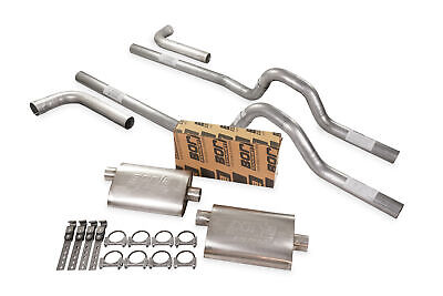

Being that we got new headers going on, it makes since to put new exhaust on all the way. Kit in bound

Musta had 'em ordered before you asked??
And now the order is cancelled. The eBay seller got back and the kit being offered is only mufflers and pipe back. This doesn’t do much for me.

Going to need a muffler shop to connect the headers to any mid pipes. The kit is still useful if that is the one you want. Not much bending up front so less chance to crimp pipes too much. Nice mandrel bent tailpipes are a plus.
