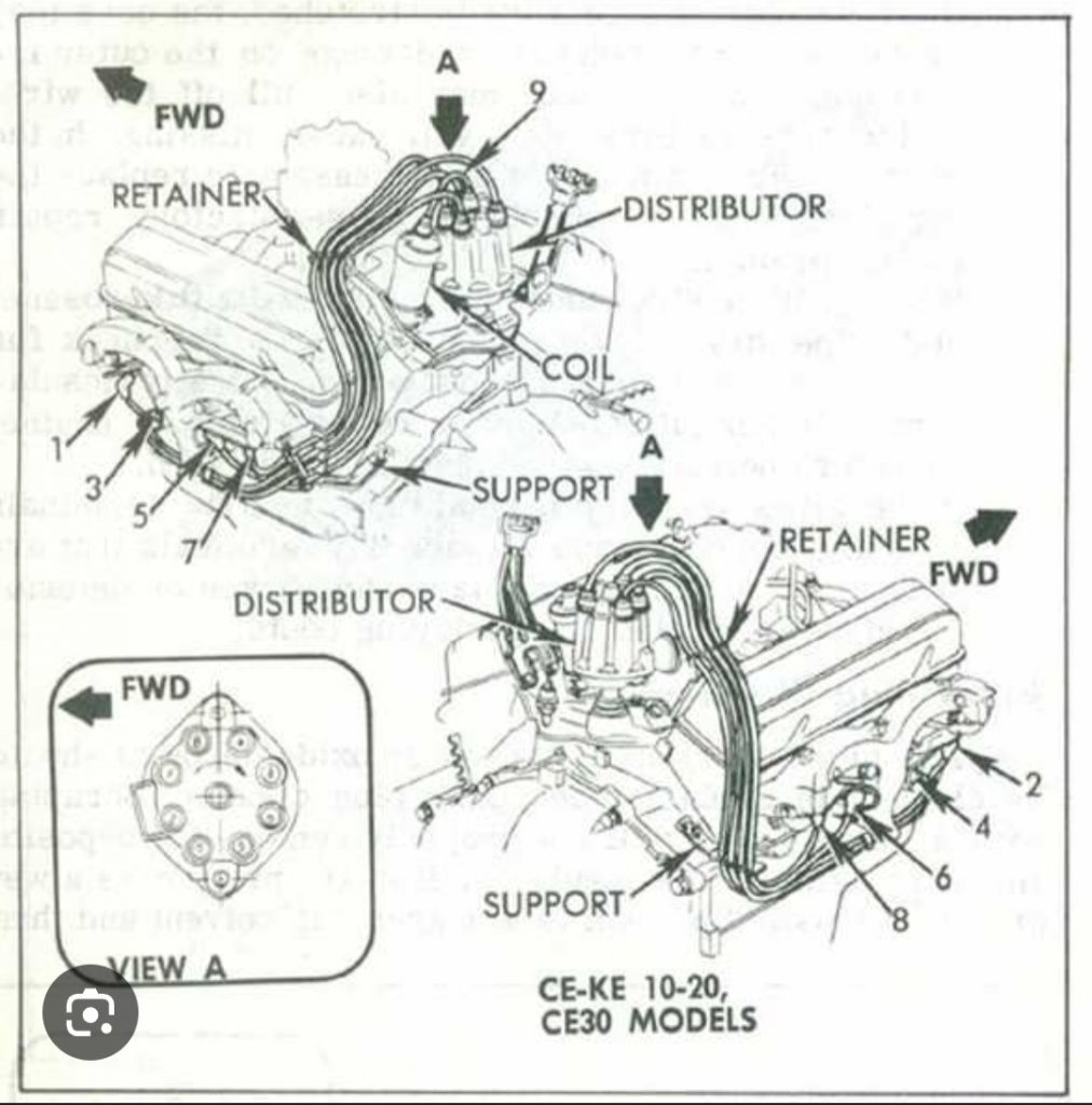

Does anyone have a picture of the factory routing for plug wires on the 80's model 305 engines? I'm thinking 1,3,5 go under the manifold??? but I can't remember how the passenger side wires were routed from the factory??? Thanks!

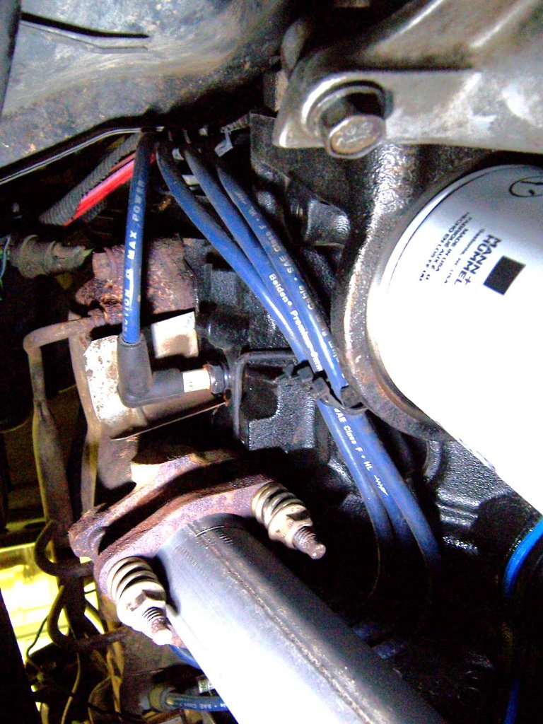

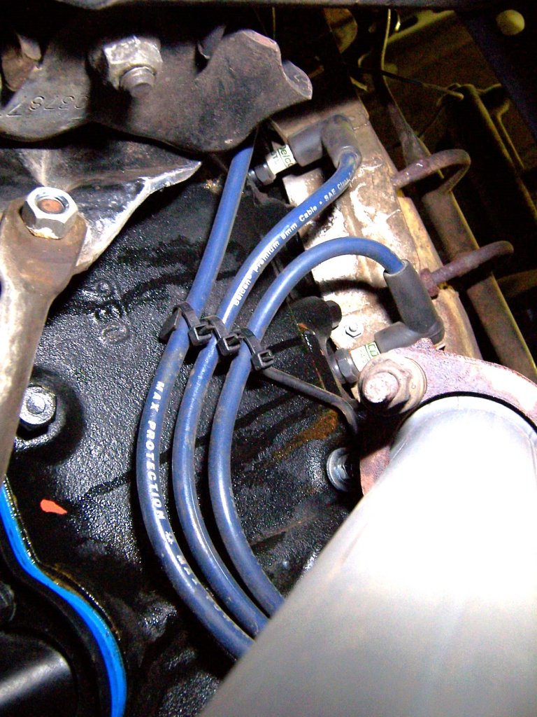

There is a wire bracket with plastic molded to it for holding the wires away from manifold and header pipe.

They didn't but it's still the same plug wire routing. Down the back of the block and low on the sides.
