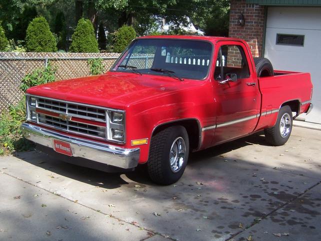

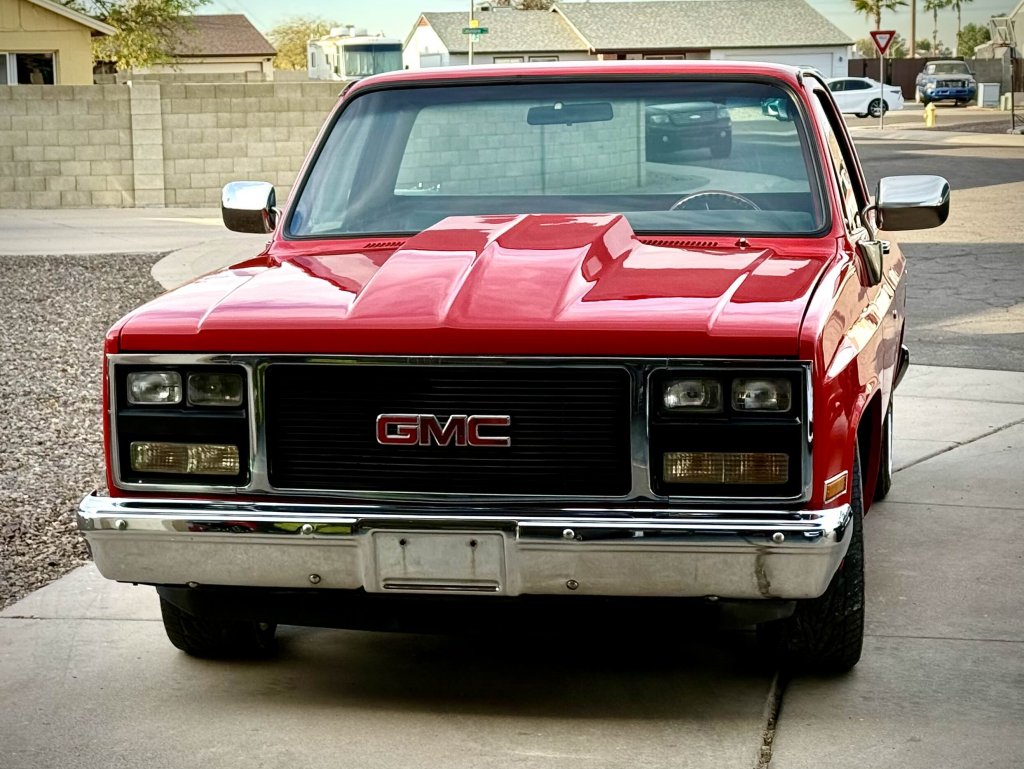

I just purchased my truck(kind of on a whim to help a friend), and would really like to upgrade as lights from 1985 aren't very good. It currently has the quad side by side head lights with the turn signals below. I have been researching on what I need to do to go to a stacked headlight setup, but I am struggling to find what is the correct thing to buy. I am wanting to replace the entire grill/surround as the chrome is cracking/peeling as well. So I figured if replacing all of it might as well go to the stacked headlight setup that I like the aesthetics of more. I am not opposed to keeping the quad head light setup if I can find a grill/surround to replace the current along with headlights/turn signals that don't suck.
Please go easy on me as this my first C10 and first vehicle I have ever owned older than me.
I have attached a picture to show the front end on the current truck.

Those actually aren't the lights from 1985.
That's a 1988 - 1991 square (R/V) front end that someone has grafted onto your truck.
Your original front end would look like mine (only GMC rather than Chevy).
As far as the changeover: I think you'll need the radiator support and all the associated attachments with that.

That looks like a nice ride from the pics. I agree with @Keith Seymore that it's an 89-91 nose. I have just done the same conversion on my 87 V10.
All four headlamps don't illuminate on that setup as they would on the factory 85. There are many complaints about the lack of upgrades too.
I'm not there yet, but I'm going to wire in an extra relay for the high beams so they'll burn with the low as well. The relay should take the extra amperage load off the headlamp switch (hopefully).

As others have said, your truck has been converted to the '89-91 R/V style front end. You'll first need to at least take off the grille and headlight bezels to see how they did the conversion. You may still have the original '85 core support behind there or they may have done it correctly and changed it to the later one. Also on the harness, look close toward the bulbs and see if they cut/spliced anything. You may or may not still have your original harness.
If they converted it properly (changed the core support, the whole front harness, etc), you'll need the proper '85 core support, front harness (you may be able to modify what's there), the '85 headlight buckets/adjusters/springs/trim rings/headlights/marker lights and grille/headlight bezels. I think that pretty much covers it.

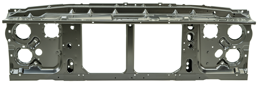

'85 dual headlight core support:

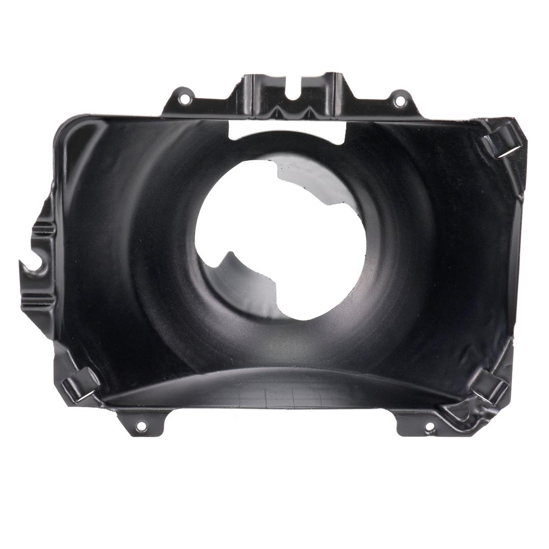

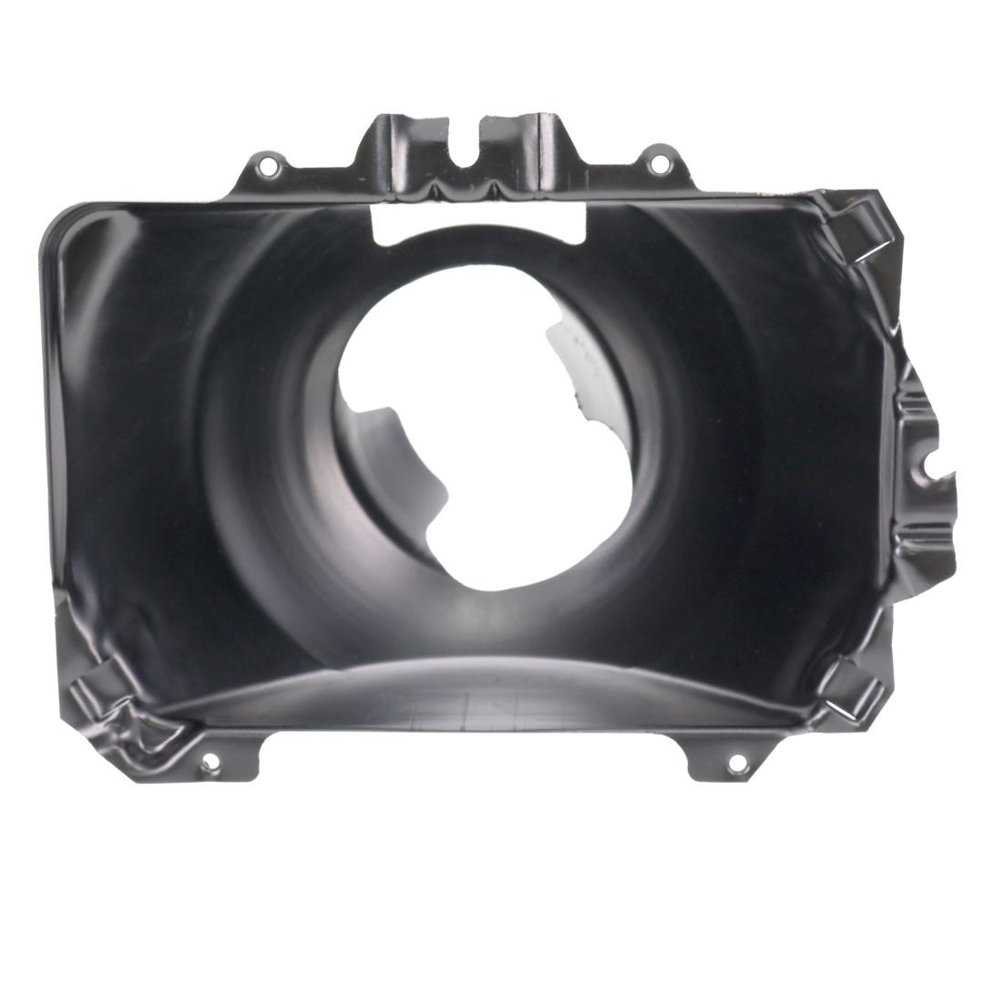

LH upper headlight bucket:

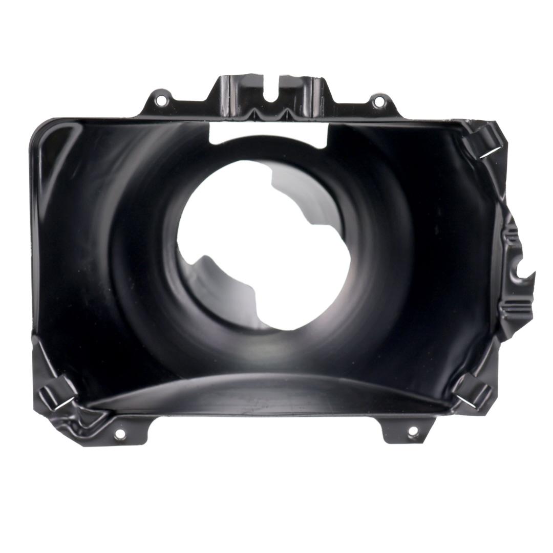

RH upper bucket:

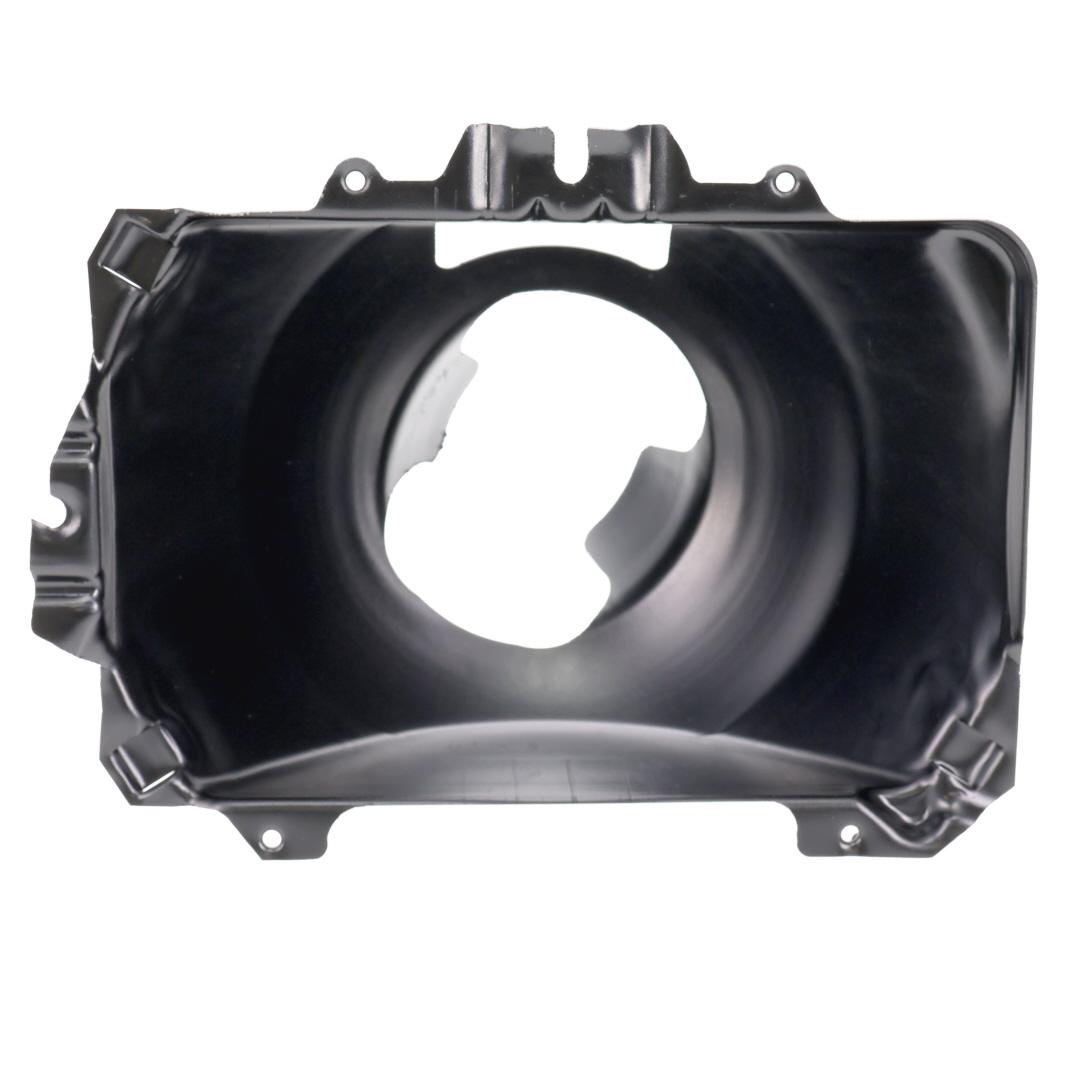

LH lower bucket:
RH lower bucket:

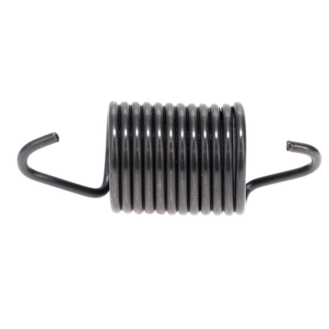

Adjuster spring:

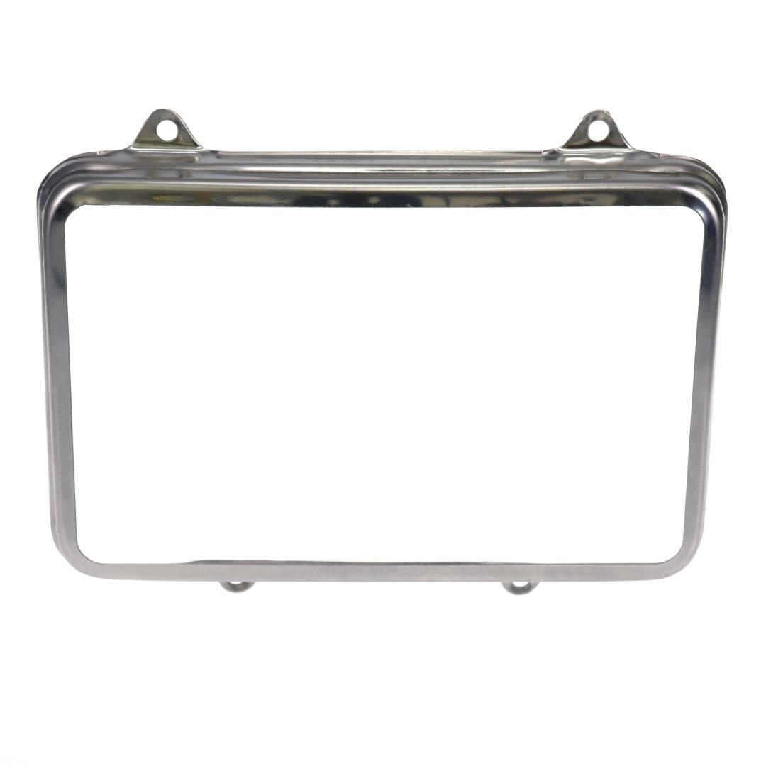

Headlight trim ring:

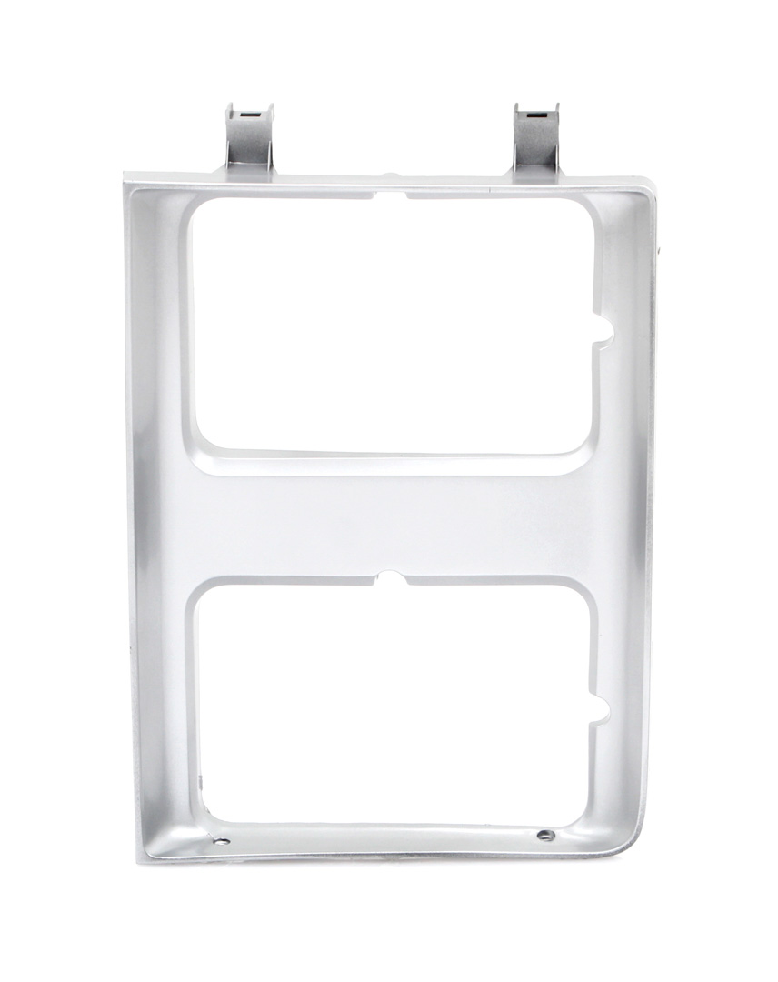

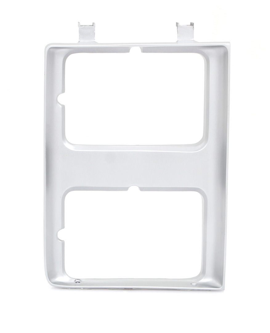

LH headlight bezel:
RH bezel:

Thank you all for the information. Very much appreciated. Makes sense why it wasn't matching up to a 'normal' 85. Lol
