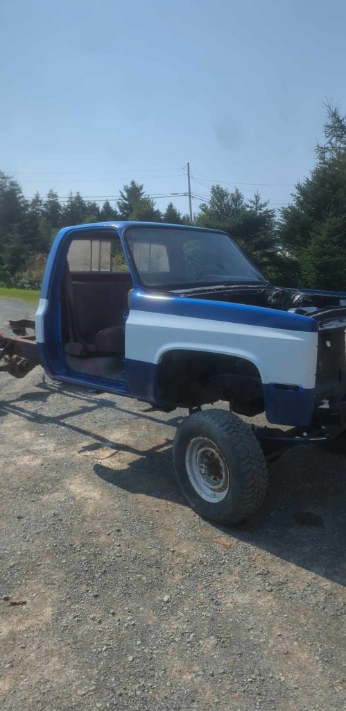

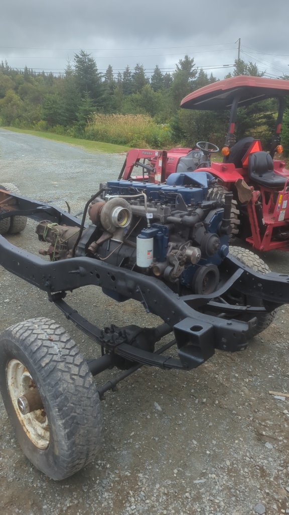

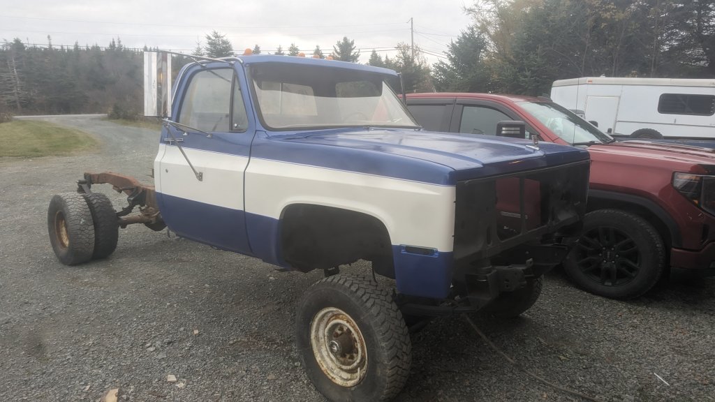

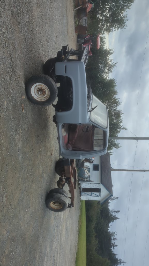

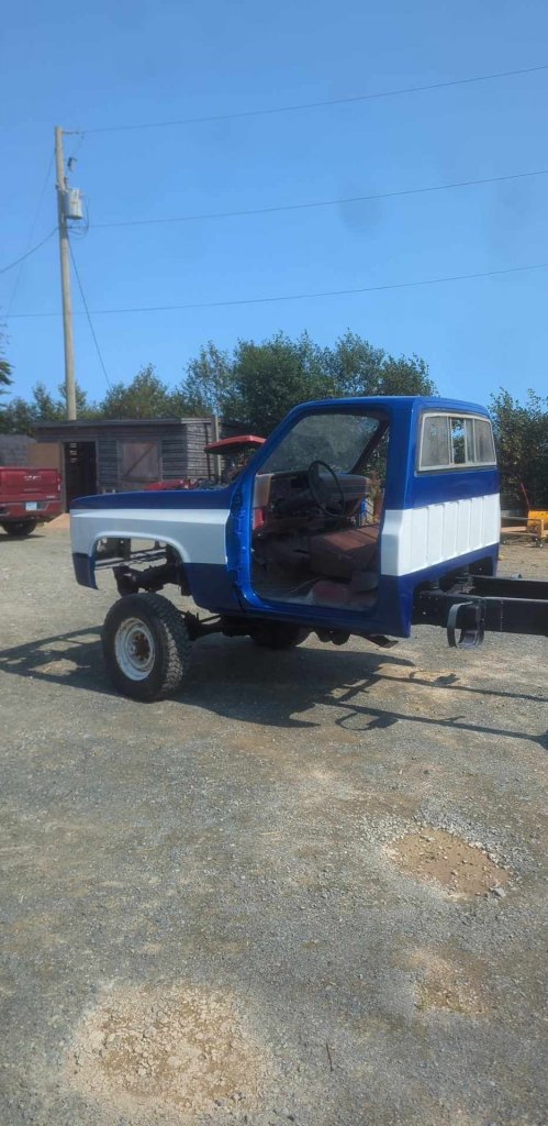

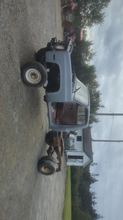

Finally got around to getting some progress on my 12v swap. Truck started out C30 cab and chassis. Swapped Dana 44 I had I under it. Got a 12v pump out of a 94 with a 47rh trans.
Used the gforce conversion crossmember and motor mounts. Offroad design for the Springer hangers for the straight axle.

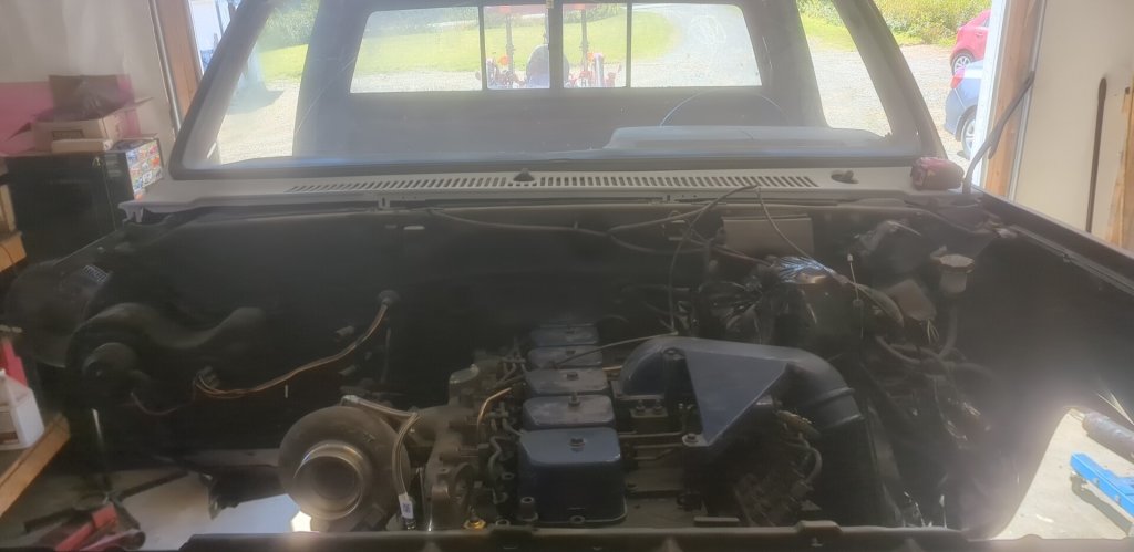

Engine with perfect with the crossmember and mounts but will have to lift the body got clearance for trans and tcase.
