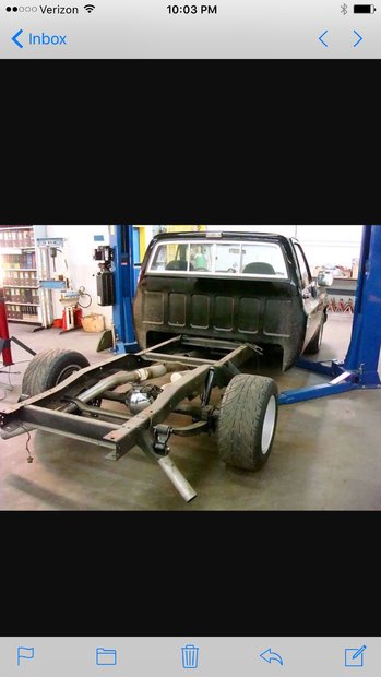

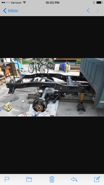

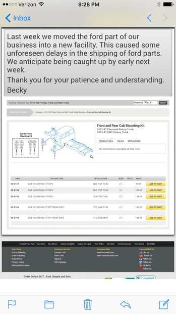

The mounts are a bit different on the frames probably in the same spot. Older trucks appear to have individual rear cab mounting and newer ones have a crossmember and it also appears to be 3 different styles of bushings.
30,407
28,204
You use the bushings to match the year of the frame. When mixing a newer frame with an older front clip, the core support mounts are in slightly different locations. It's nothing that can't be overcome with some grinding/drilling/slotting or some custom mounts.
