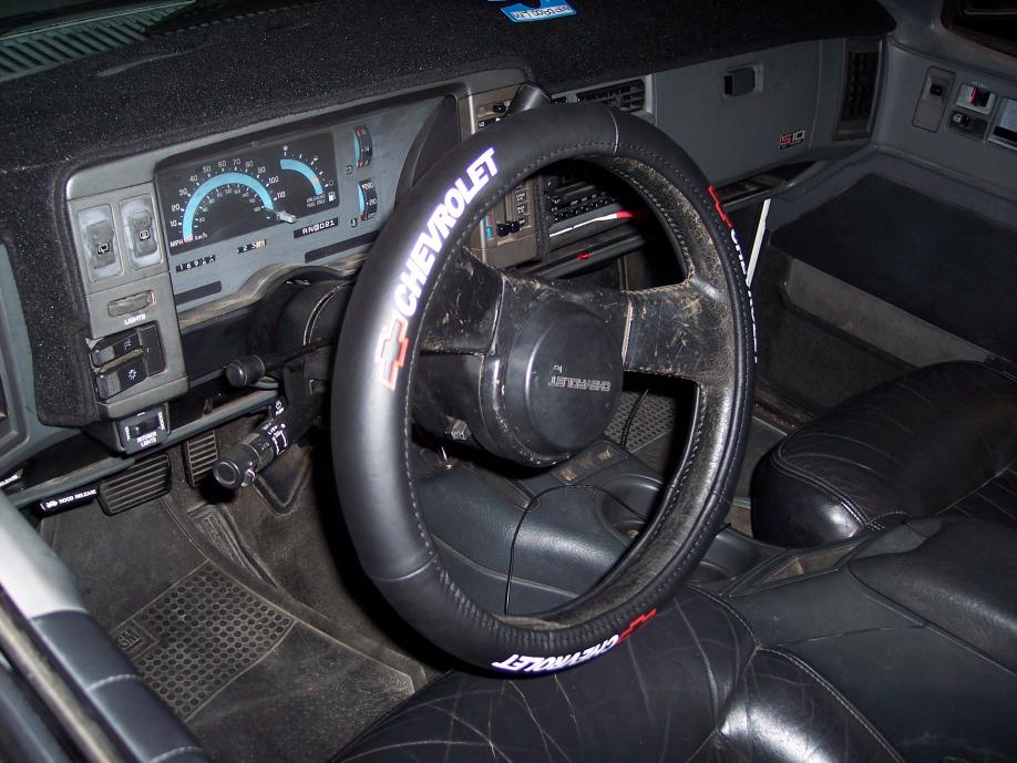

I made a telescopic column for my 1991 S10 Blazer using 1989 Cadillac Deville parts on the original column and a Corvette wheel. It was actually rather easy.
Someone here may have a better idea with using a shorter column and then perhaps you could add telescopic to it for when you drive it. This is because the telescopic column actually ADDS about 3/4 inch to the overall length.
Perhaps using a late 70s-early 80s Cadillac column. If you wanted to use a Chevy wheel, you could do what I did and use a 1984-89 Corvette wheel with an S10 horn cap. It's smaller and has a fatter grip than a Cadillac wheel or a 1970-82 Corvette wheel.
This is all assuming you want to keep the stock look.
Here's a pic of my Blazer.
attachment.php
If you decide to go this route, let me know and I will gather a list of parts you will need. I have less than $60 in the entire project.
