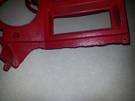

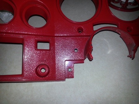

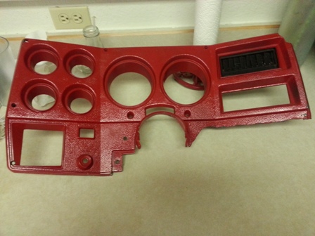

Bezel Pics
Here are a couple of pics from my bezel. White gauge housing doesn't look much better.
I have found a couple of clusters including bezels on CL but not sure if the year will fit/work in my truck. I know for a fact that one of them has electric gauges so that might not be an option. Can I put electric gauges in my truck? Right now, the oil pressure and the water temp are mechanical.
Thanks for the help.
As far as your dash bezel, you will want to get one from 73 to 78 only. There is a bunch of people out there that says they are all the same, NO THEY ARE NOT, you have to have one that fits you dash, and dash pad, and you have your windshield wiper switch on the dash, so you have to have the hole for that. My suggestion is go to LMC or someone like that and buy a brand new one, a little more expensive but worth it in the end.
